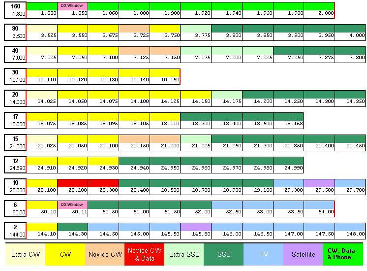

I don't know anything about WinTV cards, so I looked them up online. Seems as if the card can also be used as an FM receiver--and your FM broadcast band is 88.1 to 107.9 FM. Aircraft is around the 120s, 2-meter ham (last line in first image) 144 to 148. Public Service/business will be 150 to 160 or so, railroads in the 160s and I think (without looking), marine is in the 170s. So if you can push it past 107 into the 150s, you can get the organizations still using analog--plenty are. I'm in a major metropolitan area and I can hear almost everything with an old 20-channel scanner that does 144-172 MHz and 444-450 MHz..
See second image for info on band-plan for current public safety frequencies. Also read over the text in its source: http://www.911dispatch.com/info/700_plan.html
If you have the stomach, read over the actual law outlining the new public-service frequencies. It's 312 pages long. Just skim it for the diagrams--it's the source of the second image provided.
In any event, you'll still need the software to follow the ball, as it were. But if you've got all that in place, it mighty be possible to use the TV cards as scanners.
